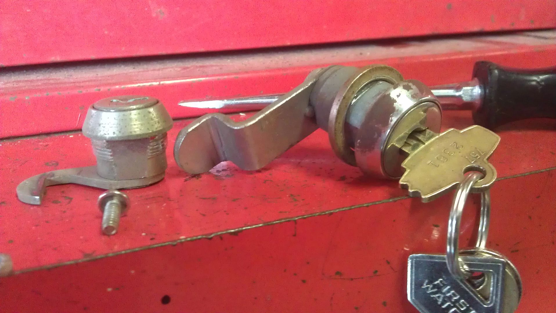

Doing some research on a possible resto/repaint of this box. Top is KRA 61B middle KRA461 bottom KRA300D and side KR274
I've yet to locate a replacement drawer but I moved them around and have a small storage space at the bottom now. I haven't figured out how to remove the roller door yet. It looks like the channels are riveted on. I also haven't figured out how to safely remove the snap on badge from the side cabinet. The right clip is inside the center channel.

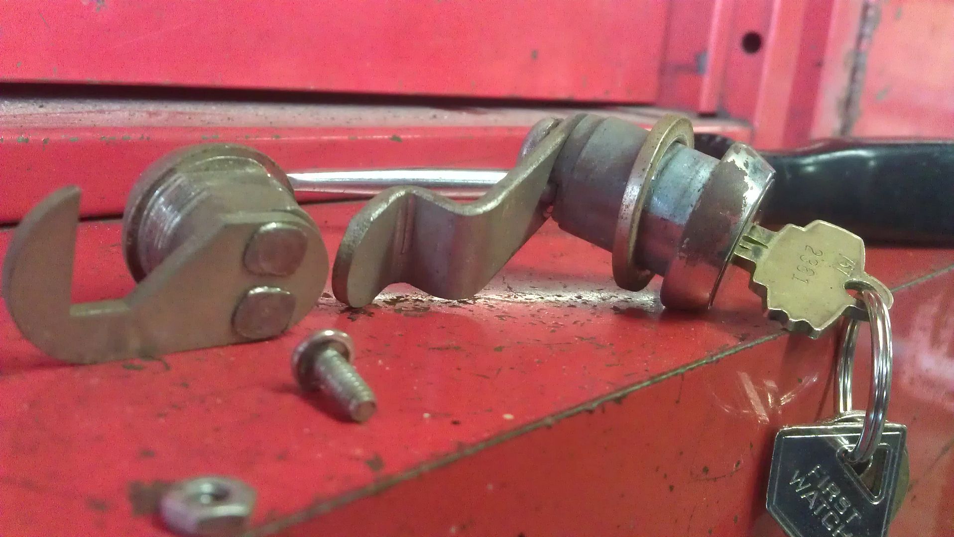

I did figure out how to remove the lock from the bottom. Its easy once you remove the handle from the roller door. However now I've run into this. The middle side and bottom all appear to use the same depth lock while the top is about 1/2 that. So I was thinking I'd buy a matching set of 4 new locks from snapon but I'm not convinced they will work in the top box. Thoughts?
