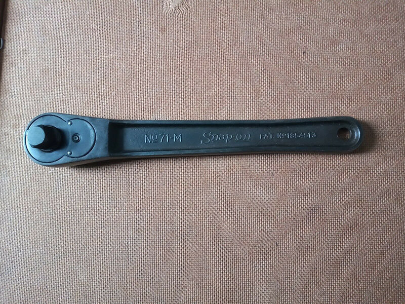

So the reason for post is that i kind of collect good tools and snap-on of course being the main quality brand. I have just purchased this 1/2" 71-M ratchet and cannot find anything on the internet to confirm its 100% genuine.
I from whats available think its got a 1995 date symbol but it has the older logo and the end hole does not look the same as vintage 71-m so all in all does not match with anything i can find? What do you guys think?
71-m front 800.jpg (226.91 KiB) Viewed 14819 times
71-m back 800.jpg (215.71 KiB) Viewed 14819 times
Re: Genuine 71-M?
This is a odd one. Looks like it may have been an industrial version, looks like the hanger hole was added. usually the 71M has a factory hole, so this one has a different type of end. I would say it is real. Post a close up pic of the date code. the 71M was made in the 50-60s.

I too thought the hole might have been added and will add photo when i get the ratchet but going off the large listing pic i have it definitely looks like 1995 symbol which does not make sense at all???
Re: Genuine 71-M?
looks similar to a gs71

Yes i agree :?

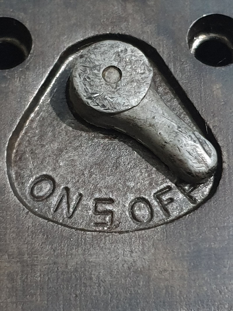

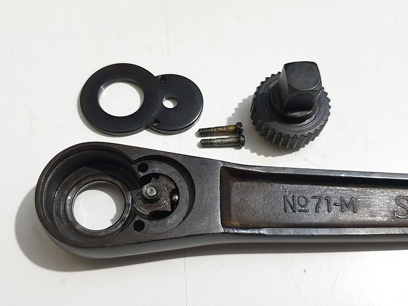

So here are two more closeups as the ratchet came today and looking close the date code seems to be more like 55 which would make more sense.
71-M INTERNALS.jpg (86.97 KiB) Viewed 14796 times
M-71 DATE.jpg (209.14 KiB) Viewed 14796 times
Re: Genuine 71-M?
This probably started as a 20 tooth, been up graded.

Thanks snapmom :)
Well i must say it feels nice with the extra teeth. And re-checking the date code it appears more like 1965 so i wonder if as being different from the usual it may have been a test for a higher tooth count?
What do you think? Also when did they stop the 71-m?
Re: Genuine 71-M?
About 66-67

Re: Genuine 71-M?
Post by Snappy3rdGen »
No. 71-M
Flat Reversible Ratchet with the modern Lever
1948-1965
71-M
Flat Ratchet
(20 tooth)
1950-1965
Per collecting snap-on forum
https://collectingsnapon.com/1-2-drive-ratchet-adaptor/
Collecting Snapon
For Collectors and History Buffs
I just cleaned one up with a date code from 1961.
