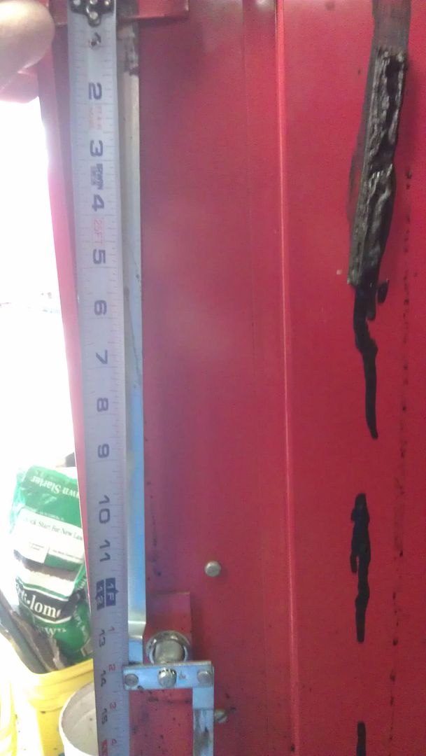

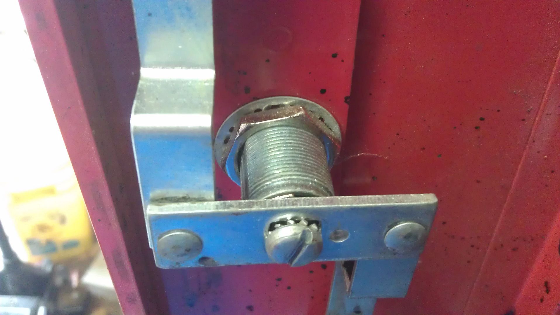

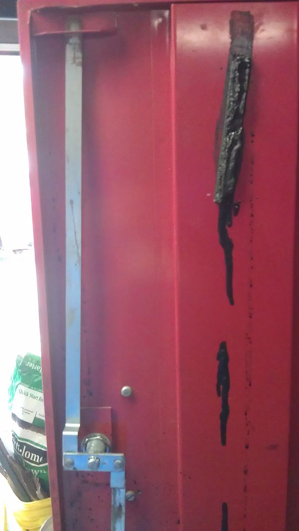

			I'm trying to find a replacement lock here in the uk. Not easy
								Slapheadyeti
		Posts:  24 		Joined:  Thu Oct 11, 2012 2:21 pm
											Your Location:  South Kent UK
						Post
								by Slapheadyeti   »  Fri Nov 30, 2012 6:37 am
			Afternoon all. A quick update. I have sourced some Stainless to repair the lock and bars. Im now afetr two runners. I saw my Local dealer today who  wasnt all that helpful to be honest. Still, he gave me a couple of screw to repair ratchets i have.
Anyway, any idea if there was a replacement to the early runners. Its only the small retaining clips that have broken?
Ill get a pic up later.

			you can make some replacement clips and pop rivet them in.

			Hi, I'm a dealer in Sussex, this is what you need
New lock is k1LA, cam for lock is 8-8537-1, lock spacer 8-13637-2
Runners are 8-657 and runner remover 52638
