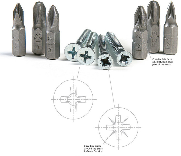

What Is Pozidriv?Pozidriv bit and Pozidriv screw
Pozidriv, commonly spelled incorrectly as “Pozidrive”, is an improved variation on the Phillips drive design. After the patent for the Phillips head expired, the company GKN Screws and Fasteners created the Pozidriv design.
The Pozidriv drive style was originally formed to address the largest issue Phillips heads are prone to: cam-out. Cam-out is defined as the slipping out of a drive recess that occurs when torque exceeds a certain limit. The Pozidriv drive style has the same self-centering design of a Phillips drive style but improves upon the two following factors:
Increased torque without cam-out
Greater surface contact engagement between the drive and the recess in the fastener head making it harder to slip when installed correctly
Can I Use a Pozidriv on a Phillips Screw? Or Vice-Versa?
While we at Albany County Fasteners do NOT recommend using the improper drive style on a screw, technically speaking you can. A Phillips drive style fits into a Pozidriv drive recess decently when using the right size. It’s important to note that even if the Phillips does fit snugly into the drive recess, it is still much more likely to strip or cam-out than when using the proper driver.
Alternatively, you can attempt to remove a Phillips screw with a Pozidriv drive but they do not fit into the Phillips drive recess snugly and are much more likely to slip or damage the recess during removal.

How Do You Identify A Pozidriv Screw?
While Phillips and Pozidriv screws look similar, Pozidriv are actually quite easy to recognize at a glance. This is due to four notches marked into the head of the Pozidriv screw that are not present in the Phillips Head Screw.
Phillips Pozidriv
Phillips Drive Recess Profile Pozidriv Drive Recess Profile
