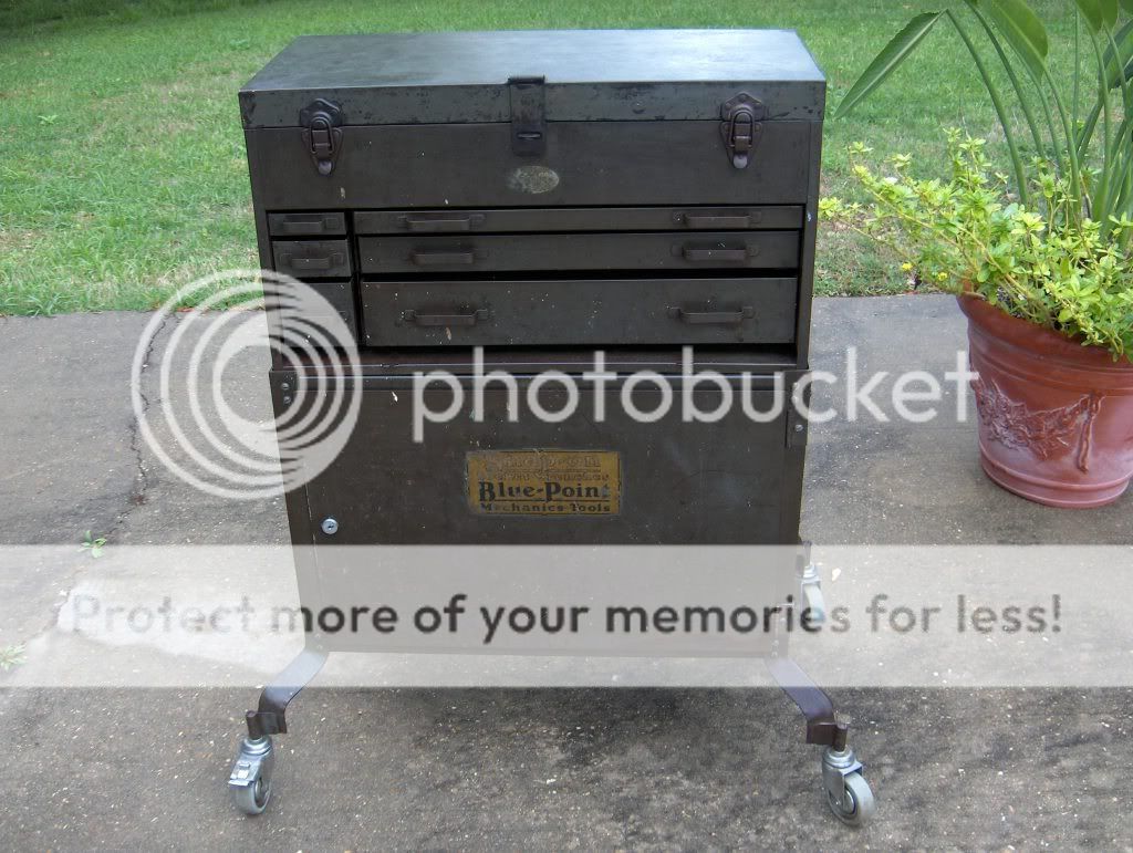

I just picked these up the other day. I don't beleive that they ever went together but know that they have been so for at least 25 some odd years according to the man I got them from. The bottom PRB-6A was made in 1939 and I could not find a reference to it being made, or find it in the catalogs after that. This particular PRB-6A has the added DR-5-A drawer set added on. It appears that both of these boxes have been tinkered with slightly, and possibly repainted at one or more points in their life.
The PRB-6A has had the hinges brazed on, a handle brazed onto the key cylinder, the wheels changed and it looks like the legs have been cut off and brazed a little higher up. I'm not too farmiliar with the construction of these older snap on boxes, but i'm going to stick to the line of thought that anything brazed on this box is a modification or repair. While some of these "fixes" are at least somewhat clean, i'm going to attempt to make everything the way it was.
Here's some shots.
The man i got it from also referenced an oil can squirter and bracket that used to be attached to the box, but he lost. This is where it went. Was it a Snap On option?
Now.... the K-55 is in fairly good condition. First appearance I could find was in '42. Two of the drawers, on one slide only, slide too far and come out and there's holes drilled into the lid and the body for a pad lock. So, the key is missing as well as the two lock bars and peice that covers the drawers when locking it up. The Snap On logo is there and in halfway decent shape, and I found a "Made In USA" stamp in the back middle of the box. This box appears to have been repainted as sand paper marks are evident here and there. The bottom of the box, almost looks as if it was replaced the metal is in such good, shiny shape. If it was, someone was very good at their job, because it is clean.
Here's the bottom I was talking about..
I have a few questions about these. But will chime in later... Enjoy!

well that explains why i couldn't see it! The 38 cat isn't listed! but as a quick update, I've got the whole box taken apart and I have a theory on why the legs were buchered as they were. My best guess is that someone wanted the box to be a little taller. As it was, the box was about 5 inches taller then advertised.
I lucked out in that 3 of the legs were and the hinges were only brazed on there, so i'll be able to use the bent angle for the casters and i'll just cut and reweld the legs back together at the appropriate height. I simply heated up the braze and pulled all the junk like casters and "bottom rack" off. So far i've patched all the holes in the skins. I debated making up a new back panel because the original had a slight ding in it and it was a little tweaked. But, i think i'm going to leave well enough alone, i don't want to replace anything unless it's rotted away and completely un usuable. Also i figured out why the box didn't sit level. When the previous owner welded the new legs on, the bend in the angle iron wasn't symetrical and the were welded with 2 right side up and 2 right side down. go figure. I'll have pictures up of the progress and how I patched the holes hopefully this weekend if time permits.
